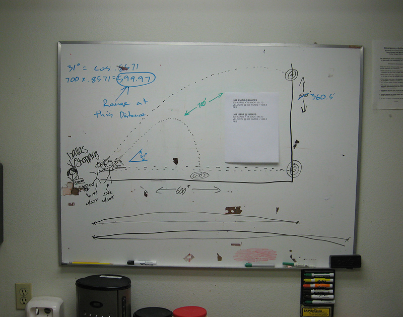

So, the other day this topic came up at work and I was trying to explain the concept of ranging your shot when shooting up or down extreme angles. It turned into quite the debate and no one wanted to believe me initially. It took lots of diagrams and such but I think everyone is starting to understand.
Basically, lets say you are shooting a shot on level ground at 600 yards and get all dialed in. Then you are shooting up a hill at a 31 degree angle and range your target at 700 yards, you will still dial in for the 600 yard shot because your bullet drop is relative to the horizontal distance traveled because gravity pulls to the center of the earth, not the ground.
I got as detailed as to show how to calculate the adjusted range using the angle cosin and such. Here is the diagram drawn in the kitchen on our white board.

Ayep. 8-) Good for you educating the masses. I have a fellow at work that wants me to take him long range shooting, but I can't make him understand how tedious I will make it for him. :lol:
Also, in your example, you still have to fine tune for windage, which can have a vertical factor. :twisted:

Yeah, and technically you have to calculate the velocity changes from shooting up against gravity or down with it as that changes things to. But yeah, you know where I'm coming from.
